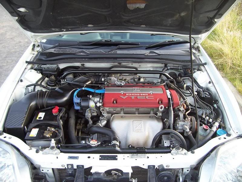

In order to produce more naturally aspirated power from an already powerful engine, Honda realized that it must improve on such things as intake resistance and heat dissipation.
The H22A engine received yet another dosage of Honda's racing technology and custom engine work. Though not as widely known, the Type S engine, like the
engine,receives a port-&-polish job from Honda.
Engine
Improving on its already sky-high 10.6 compression ratio, Honda created a new pistonhead that increased the compression ratio to 11.0. By doing so, the burn-off response increased,
helping heat dissipation, as well as improving torque throughout the powerband. The VTEC valve timing, lift, and duration were also adjusted as well. The valve lift on the intake
reaches 12.2mm, while the exhaust end reaches 11.2mm. As far as production engines go, these are really high numbers.
Intake
Port & Polish Honda felt that it would need to improve on the intake path to compliment the increased high-end performance. The air intake box was made into a funnel
shape -- utilizing what Honda calls "dynamic chambers." The throttle body was also bored out from 60mm to 62mm. Even the material used in the inlet manifold was changed to a more
fine, granular one in order to make it more smooth. The valve seat was re-adjusted from 60 to 45 degrees. Finally, the cylinder head and intake port was treated to a manual
port-&-polish job by Honda technicians. Honda is making these engines as if they were meant for the track.
Exhaust
By lowering the intake resistance and making an engine that burns efficiently, Honda needed to finish its tuning job by allowing for the exhaust to get out smoothly.
The exhaust manifold, while retaining its outer diameter, had its opening size increased. The dual-pipe design to follow was made truly cylindrical, (as opposed to oval)
and the wall lining was made to 15mm -- decreasing exhaust interference. The catalytic converter was also increased in size, and the exhaust piping increased
from 50.8mm to 57mm. The silencer efficiency was increased from 97 liters/second to 113 liters/second. This completes the improvements made on the air flow efficiency of the
Prelude Type S.
